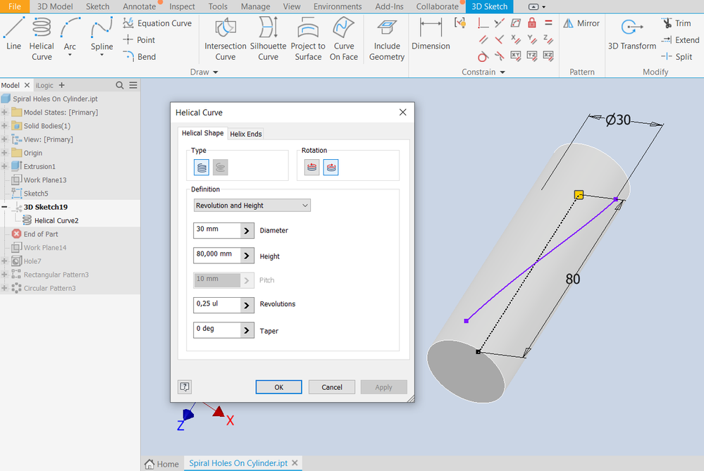

First you have to create Spiral curve on cylinder with 3d-Sketch with desired diam, length and rotate angle:

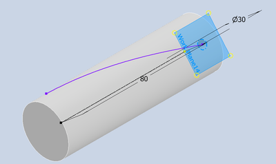

Then create a first Hole on tangent plane to cylinder in first spiral point.
Next use Rectangular patern along spiral, It is important to select Orientation to "Direction1"!
At last use Circular pattern
Example is added in IV2023.

Thank you very much for the detailed explanation Alexander, I never think of using the 3D sketches.
