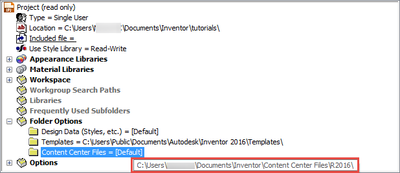

Check this path in your project file, this is where parts placed from the content center will be stored.2015-08-07_7-51-24.png

Hover your cursor to the content center files option below the folder option in projects you will get the location of your parts located in your content center library
