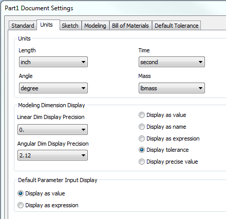

メッセージ13/15
Davey_van_den_Berg
to edit the percision od the mass property you'll have to do this:
1. open you Parts list
2. right click on mass
3.  press format column
4. set pricision to ...
i've added 2 pictures
Please click solved 😁,
Davey
メッセージ14/15
marilyn
Thank you for the information, your solution will effect the the parts list and that is not our issue.  Our issue is in the IPT itself.  If you go to iProperties and put in "mass" you will get a big number (weight of part in grams) which in my case is 6 decimal places.  I want to make that 0 or 1.  All our issues come on the 5th or 6th decimal place being different by 1 or 2 max.  This would represent a weight difference of 1 or 2 ten millionths of a gram.  Thanks for trying to help me.
0 件のいいね
メッセージ15/15
Davey_van_den_Berg
Sorry for the late reaction.
this will be for people with the same problem.
This is possible, but it will effect all parameters within inventor.
what does this mean?
it means that if you link a parameter from another part, it will also use that precision.
(if d1 of part1.ipt =3.141592 than d1 of part2.ipt will be 3. if you set precision to 0)
