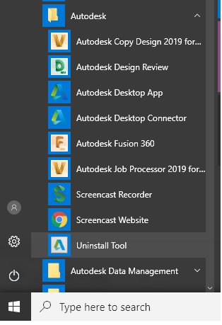

I just installed Inventor 2020 today and when I went to start it up for the first time I got the following message, "Could not start the Autodesk Desktop Connect Service. The required services (Autodesk Desktop Connect and Guided Tutorial Plugin) may have been uninstalled." I tried uninstalling the software and reinstalled it and I am still having the same issue. What should I do to fix the problem?

You may be able to resolve the issue by running \Setup\x64\LWS\AutodeskDesktopConnect.msi as described in the articles Xun provided.
For reference, you can access the Autodesk Uninstall Tool in these two ways:
1. Select the Windows button in the lower right of your desktop and select Autodesk to expand it.
    Select the Uninstall Tool button:
2. Type Uninstall in the "Type here to search" box and Autodesk's Uninstall Tool should be a match. Select it.
Thank you,
Clare

I was able to fix my issue with the Autodesk Desktop Connect Service. My native drive is my Hard drive and all of my Autodesk software information on my hard drive but my WI folder was in my C: drive. I was able to reinstall all of the needed software for Inventor.
