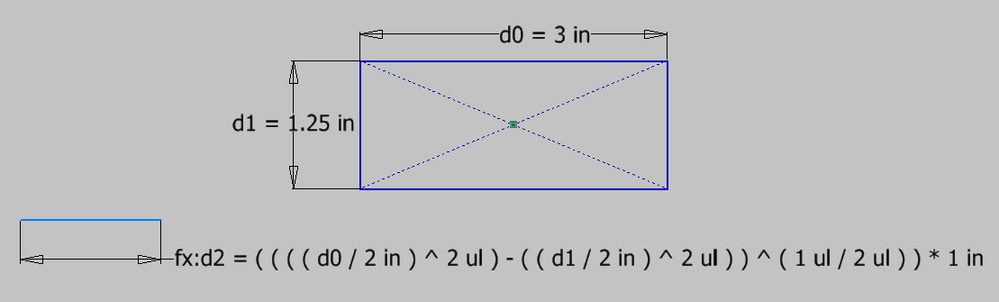

Is it in any way possible to finish this whole equation "See Attached" with a Square Root?

TheCADWhisperer
Have you accounted for the units in your equation?

Cant get attachment to work, but heres the equation ( ( d4 / 2 in ) ^ 2 ul ) * 1 in - ( ( d1 / 2 in ) ^ 2 ul ) * 1 in

TheCADWhisperer
What are your expected outcome units?

( ( d4 / 2 in ) ^ 2 ul ) * 1 in - ( ( d1 / 2 in ) ^ 2 ul ) * 1 in This is the outcome of my equation without Square Root. "1.859375 in" Now i want to know how to put square root to my equation so i get the √1.859375 in

TheCADWhisperer
d4=?
d1=?

d1 = 1.25 in. d4 = 3 in.

TheCADWhisperer
Something like this?

Thanks a lot!
