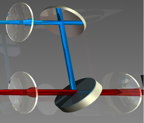

Hi, is it possible to render an assembly in inventor / studio, and prevent some objects to cast shadows and reflection in the others?
The idea is to sketch a setup with mirrors, lenses and a laserbeam, where the beam (manually modeled) is visible, but does not cast a shadow, or the reflections are visible in the other objects of the assembly...

in principle, the rendering capability of inventor studio is satisfactory for my needs, so that is not the issue.
the detail I want to resolve is the reflection of one individual object in all other ones. see the example picture attached, the 'beam' propagates through the lens (top left) and is then (manually) reflected from the mirror. the polished surface however also shows a reflection itself, as if the beam was a solid object. being not so physically correct to see the beam at all in the first place, it is much more disturbing to also see the mirror images.

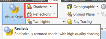

Do you really need Studio Render
or
would Realistic Visual Style without shadows or reflections serve your needs?
Message 8 of 16
wellerchen
@JDMather: in principle yes, the thing is, the reflections button you highlighted is only for the ground plate, not within the objects.

Message 10 of 16
Daniel248
Here's another ideea:
Rendered as two separate images in Studio, and post-processed in GIMP.
Spoiler
What’s interesting, a mirror doesn’t show its own shadow… is that a good or a bad thing for a Vampire? ;-)) Smiley Happy
Message 11 of 16
wellerchen
That might be a suitable alternative. Although I still have hope for a 'not manual' solution Smiley Happy

Message 15 of 16
mdavis22569
something like this
png
Mike Davis
Message 16 of 16
May I ask how to realize the red and blue light path?
What's the setting for materials?
