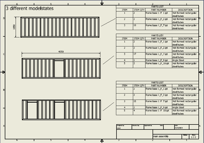

i have been testing some possible solutions. the best one still have the QTY problem but that can be fixed by using ilogic to make the unit into "EACH"
Dim pdoc As PartDocument = ThisDoc.Document
pdoc.ComponentDefinition.BOMQuantity.SetBaseQuantity(BOMQuantityTypeEnum.kEachBOMQuantity)
this however turns off the standard mm QTY, so if you want it back you will need to multiply the custom iproperty("G_L")  with the new QTY.
the method primarily uses frame_gen demoting and supress
the setup:
by demoting within the frame generator you can get some simple assemblies to put into a subassembly where they where you can construct the frame wall. this subassembly while be used in the main assembly
frame assembly:
wall assembly:
then you can create modelstates inside this assembly but not the assimblies made with frame-gen (that is doable but will require extra constraints and lots of re-applying frame-gen features)
if you decide to use patterns then be aware what feature you suppress (suppress the assembly feature and not the element. the element is not bound by modelstates)
the modelstates as they are right now might have one last thing that would be worth to consider. and that is if they should have different "part number" so that they can have their own spot each in the BOM. that can be done by activating the modelstate you want to have a diffent "part number" and just change it in iproperties.
that is it for the setup
side note to fix the mixed BOM parts: to avoid this problem use different part numbers for different frames.
here are some screenshots of my results.
400mm added to length:
300mm added to height:
if you got any questions feel free to ask me.
