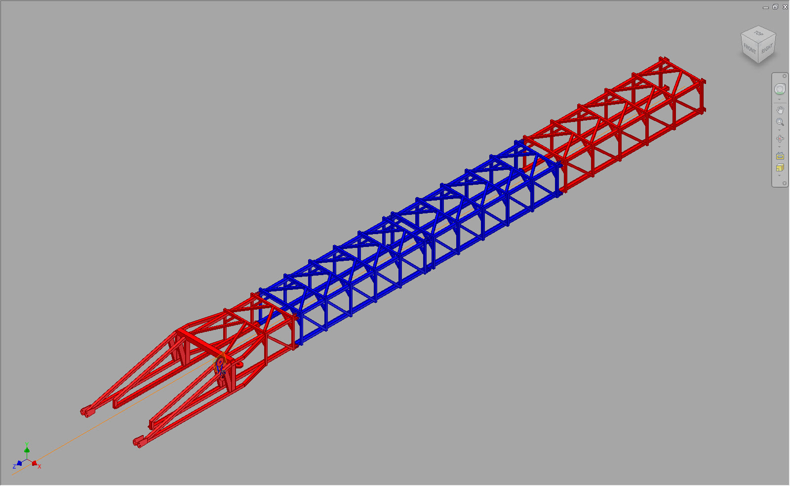

Hello all,
Is it possible to set a view repersentaion and level of detail (combine them) at the same time in an assembly. Or do they have to be set individually?
Attached images show the first assembly option with four sections together. The second image shows the second assembly option with the top and bottom sections only.
Thanks in advance.
Dan

You can create a Derived Assembly with Design View X , level od Detail Y and Positional Representation Z
Each time you enable the derived assembly these representations will be activated at the same time.
Hope help
Exactly what I was looking for.
Thannk-You!
