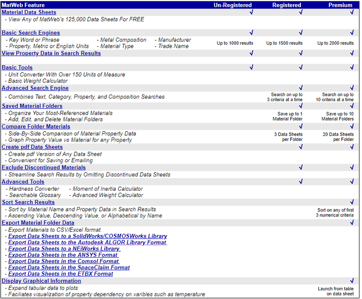

I would love to have an easier solution to this like other software do.
By having Matweb create the material database input from their database for us.
I see Autodesk Algor and Ansys on the list, but not Inventor.
http://www.matweb.com/membership/benefits.aspx
Matweb feature overviewMatweb feature overview
