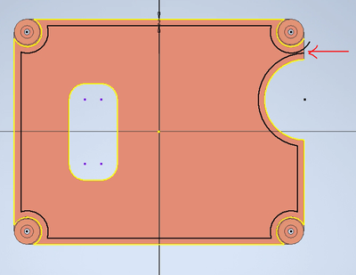

I am trying to apply a perforation pattern to an extruded face plate. The perforation is the .13 thru hole, stagger angle is 60 degrees, the margin is 2mm, and vertical spacing is 6mm.

I have placed four individual thru holes as the features that are to be perforated.  The idea is to perforate the faceplate
using the least amount of steps possible, please refer to the attached files...thx
Spacing is 6mm, stagger angle is 60 or 30 degrees, margin from vertical edge is 2mm.

Hi! I believe you are looking for Fill Pattern. At the moment, Inventor does not have the ability to automatically populate feature instances at a given spacing within a selected boundary.
The closest workflow to do that is the following.
1) Create a sketch boundary (project edges).
2) Create a center point and a rectangular pattern of the point enough to cover the boundary.
3) Select the unneeded points (outside of the boundary) and change its type to regular point (Format -> Center Mark).
4) The sketch can be used to populate Sketch Driven Pattern of selected features.

Offset the outline by 2mm, (you need to delete this tiny edge first)
Add in a line to close the loop
Project the main blank profile from the back to the same sketch
Pattern your holes
Extrude your border the thickness of the plate
Use delete face if you want to tidy up the partial holes (with heal mode on)
