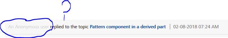

Strange..
I get this every so often can anyone on this thread see his comments because I don't...
