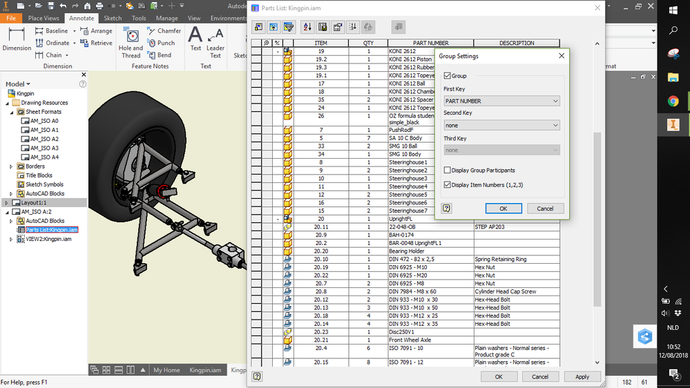

I applied what jhackney1972 suggested in his video (screenshot1). I then used the function "Group Settings", you can find this in the top-left corner of the Parts List edditing window (second to the left). I put the settings as in "screenshot2".
I think this will give you the correct result (screenshot3).Screenshot3.pngScreenshot1.pngScreenshot2.png.
