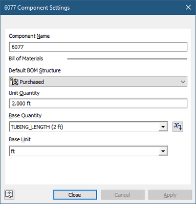

I am trying to do this but with virtual components instead of frame generator.
So let's say my virtual component is some tubing, and I need about 2 ft (i.e. not the default 2.000 ft).
How can I do this properly without incorrectly changing the rest of the QTY column's values?

Message 11 of 15
blandb
If you create a user parameter called "tube_length" for example, set the units to "ft". Now right-click on your virtual component > Component settings > set base quantity drop down to your user parameter, then that should also change your base unit to ft. Hope that helps.

SER4
Yes that is what I did, however, it still shows the 3 trailing zeros (even in your picture), but I want none (similar to above conversation).

Message 13 of 15
johnsonshiue
Hi! The trailing zero in this case is controlled by the assembly doc settings. Go to Tools -> Doc Settings -> Units -> Linear Dim Display Precision. Change it to no decimal place.

Message 14 of 15
pcrawley
And for anything that is not a virtual component, it comes from the same Document Setting that @johnsonshiue indicated - but in the original component file.
Since this post included Frame Generator workarounds to get rid of all the decimal places (and may therefore be discovered by others) - here's a link back to a post showing how you can permanently fix the problem without formatting the entire QTY column in your Parts List:  https://forums.autodesk.com/t5/inventor-forum/part-number-generation-from-frame-cutting-list/m-p/107...
