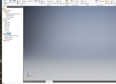

@Anonymous wrote:
The request is performed but when the .ipt window opens all the parts are invisible. I can see them in the parts tree and under the derived assembly editing window.
Shift Win S to capture image of what you see and then Ctrl V in a Reply here...  (only need this portion of the screen)

 So all of my parts move over into the .ipt screen, they are just not visible. If I export the file to and .stl, the file is empty
