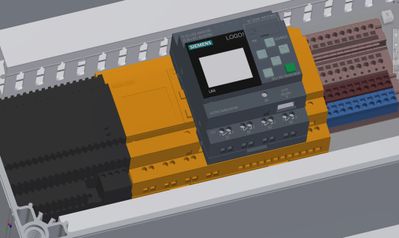

Hello Everybody,
I recently got an issue I can't seem to resolve:
Some parts in an assembly lose their appearance (surface applied)?
For example I downloaded a siemens PLC from the siemens website which was already colored. I loaded it in a assembly and it looked normally. I don't know what I did but it suddenly lost its appearance?
When I copy paste the part the appearance loads in normally.
Also when I open the part it also looks fine.
This happens when I load in parts and assemblies.
I already checked Representation and nothing works.
Any help would be greatly appreciated!
1,154 Views
JDMather
Attach example file(s) here.
Assembly level appearances override part level appearances.
alex.evers
I have some features on assembly level, when I delete the hole functions the appearance returns..?
So removing participant seems to fix the problem. Why is this connected to the appearance?
