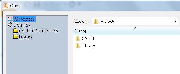

So let's say re reorganize your setup as such:
These are the "custom" files named and filed in a folder reflecting their "project" with a prefix of CA50
These are the "library" files that are reused among common designs (again this is just for example, and might not reflect your real world scenario)

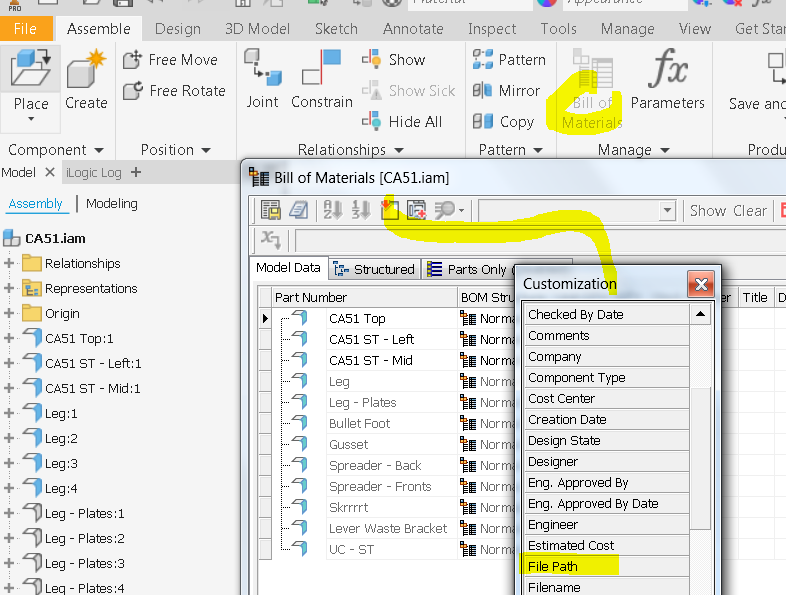

Another tip that might help you keep track of which files are looking at which files, is to go to the BOM editor in the assembly and click the Column Chooser button and locate the FilePath property in the list, and then drag and drop it into your BOM grid, so that you can see the file path... if you do this in your assembly template, it will be there for all of the new assemblies you create from that template
I hope this helps.
Curtis
