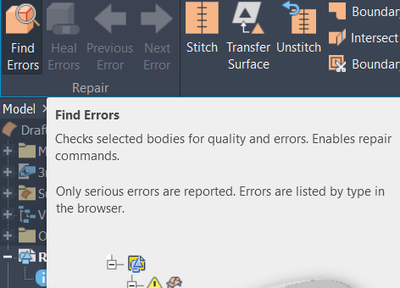

Right click and select Repair Bodies...
Select All
Well that didn't work - so we need to dig deeper...
Stitch shows where the issues are...
We enter the Construction Environment and see that there are surfaces that should not exist in the model...
In some cases there are duplicate surfaces overtop of each other...
Message 5 of 11
