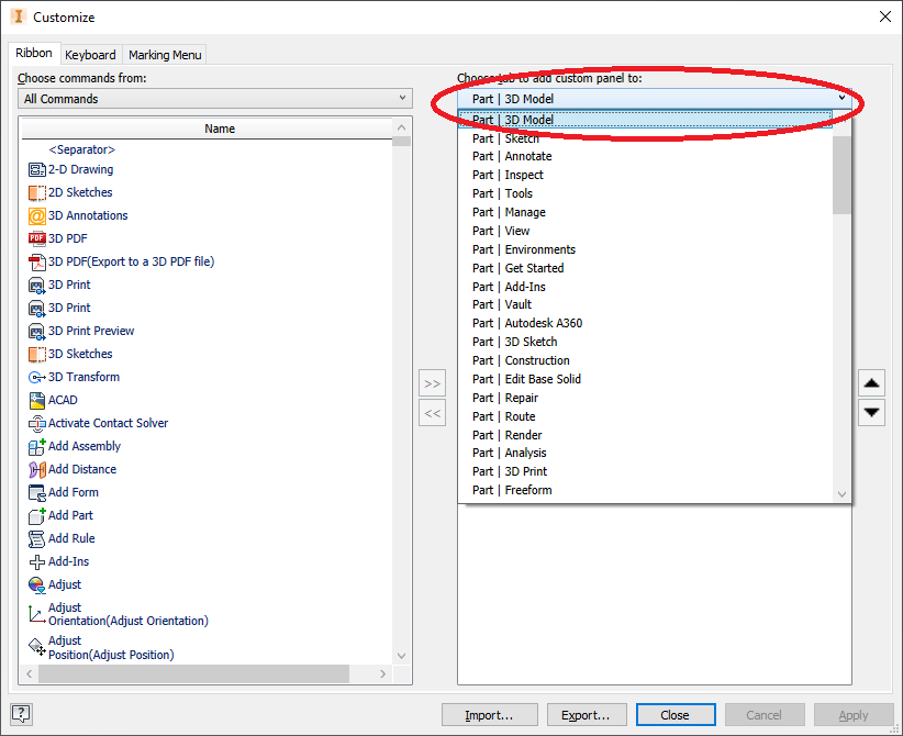

Hi guys,
There this issue that probably nonexistent for experienced users, but this drives me nuts..
I managed to write a few macros, and in SW for example I had a separate Ribbon Tab called "Macros", where I collected and organized them.
I spent quite a lot of time trying to figure out how to add a new tab in the Inventor??
There is no any "Add New Tab.." or "Custom Tab.." in the Customize menu:
What am I doing wrong??
I mean , this is a pretty basic functionality with a predictable demand..

The only access to this functionality is through "ribbon.ribbontabs" property?
Yes..
There is not a simple (through the gui via a simple add tab button or something that a non-programmer could do) option to add a new tab.. I think thats what you are really asking here..
The only way to add tabs is via programming/scripting using RibbonTabs.add method,etc....
