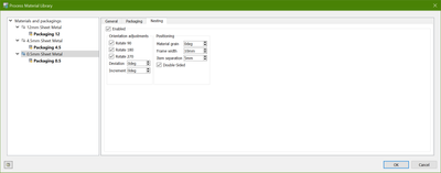

Hi. I'm having the same exact problem. I've tried all the following workarounds, but the Nest Tool still wants to create a new material:
- Add From Provider in Process Material Library
- Add From Provider and then Sync from Provider
- Make both material and thickness the same as that in the .ipt sheet metal file
- Leave Material Provider and Remote material name blank in Process Material Library
What gives? What should I do now - remove all materials and start a blank nesting file?
The images attached show what I'm going through. I really don't want to have to export to dxf, and then import again. I just want to use as few files as possible.
Could I get some help? Thanks.
