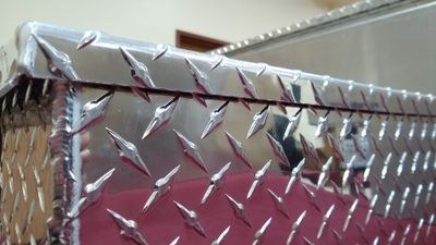

Hi All,
   Can't seem to find anything on this topic. We are a sheet metal manufacturing facility, and quite frequently deal with diamond thread plate aluminum. We would be drastically more efficient if we were able to render our such products with Inventor, as opposed to trying to set up a good photo shoot every time. Not to mention, that stuff is hard to photograph.
   here is a quick shot of what that stuff looks like in real life.
here is also a video so you can see the reflectivity of it.

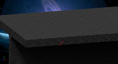

   Ok. That's real life of it. So to get this stuff into Inventor, i drew it in manually, and used Inventor to generate the bmp's that i use for a bump maps.
   Creating a new generic texture, setting the reflectivity, and adding the bump map, makes it look like this:
   Now this is actually pretty accurate. It will dazzle as it's rotated, just like it's supposed to. The issue that i'm having, is when i try to ray trace it. then it looks like this:
   I can't figure out why ray tracing kills the bump map. is that normal? has anyone else ever attempted this? Any tips would be appreciated.

Hello @jwmb224 you might want to change the reflection to chrome.dds for the best reflection during rendering.
If you try rendering through Environments > Inventor Studio you might have better results instead of Ray Tracing from the Ribbon within the window.
You can change the lighting styles and shadows to improve the washed out appearance. There are many different diamond plate appearance out of the box that you might be able to use.
If you want to supply the example part with appearance image with bump map that would be helpful.

Hello @jwmb224 I was able to use the image you provided and it rendered pretty well with a short 30 iteration run:
The way I setup was to choose Stone and make a copy of it. Then you can change out the image and bump map.
You have to Edit Image from the little triangles at right and make the Scale smaller to where it looks correct. I just put it in the Old Warehouse and tweaked the settings a bit.

Hello @jwmb224 I have had varying degrees of success using that image as a bump, but haven't been able to get it to where they show up exactly as the real life picture in the first post.
If you want a true raised profile like in real life, you might have to model them as small extrusions/iFeature/emboss then pattern, which is less than ideal. I think the bump is primarily good at creating textures and small elevations, but those diamonds are a pretty big step.
Please select the Accept Solution button if a post solves your issue or answers your question.

Hello, if you are still working on this i might have found the problem:
the .bmp you made is not a heightmap...
If you want that shine you'll need a gradiant on the surfaces wich are supposed to at an angle. Also a different brightness on the inside / outside of the diamond shape.

Hello again,
check the pattern.PNG file to see what i meant by gradient / heightmap.
but the way i achieved this is... scuffed: I am not familiar with image editing programs so i sliced the part into height sections and took a screenshot.
For more complex patterns / more details (resolution and/or gradient steps) it's easily possible to automate this technique in other Software.
Edit: possible - but the correct method would be to draw the pattern instead of modelling it. It's also usually better to add a slight amount of extra brightness to the outer "edges" of your "fake geometry" (the default Knurl Appearence is a good example)
This should give you what you're looking for, however at certain angles you will still not see any Bumps due to the Camera / Light angle.
I recommend combining the bump with a texture (and link their scale)

Otherwise check the standard path: C:\Users\Public\Documents\Autodesk\Inventor 20xx\Textures\bumpmaps
In there should be a Knurl2_bump.png, thats what i was referring to.
As for your questions:
  • The brightness will highlight the edges of the fake surface better. For actual geometry you can add a radius of realistic size (usually 0,1-0,5mm) to get the best results.
  • The Texture is not the same as the Bump. It will probably have a slight shadow on the inside corners, it will have the color of the actual material + surface imperfections... sadly i cannot help you with this as i am not familiar with any image editing software.
Also, after your reply led me to look at the Diamond plate_bump and you are correct... it is bad.

this is the closest i've ever gotten. i'm not sure if they updated inventor, or if coming back and just giving your post another run just helped. i did use your height map, even if you didn't make it the officially best way possible; looks quite real life 🙂
