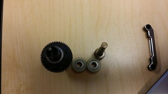

I currently have 2018 installed. My level of knowledge is about a hobbyist with trying to make stuff for 3d printing rc toys.
I am faced with making a gearbox that uses 4 gears.
gear 1 - 48P / 52 teeth
gear 2 - 48p / 28 teeth
gear 3 - 48p / 28 teeth
gear 4 - 48p / 20 teeth
I can make 2 gears by using the designer "Power Transmission" - > Spur gear but i dont know how to make all 4 gears at once.
When making the case my concern is the spacing of the midpoint of each gear so they mesh properly when all 4 is together.gear setup.png\
this is the configuration I need to make a case for but meshed properly

The actual gears are pre-made and came from my existing rc car but i wanted to rearrange to have 2 middle gears down low. I was able to get the spec of the existing gears.
I expect to do some adjustments when i 3d print the test gear case but would like a as close as possible starting point and adjust the gear case from there.
the width of the gears are all 10mm.

here is the current setup
the plan 🙂
Hope this helps
Once i get a projected geometry then i can  make it a base for the case

Are you just rearranging the gears you have? Or, are you planning on changing the number of teeth on the middle 28T gears?
If you are just rearranging, then in order for the gears to mesh properly, the pitch diameters just have to match.

Just rearranging .
I tried to draw the gears separately. The middle 28 gears i used the gear generator so the mesh is perfect. The 52 was drawn separately and the 20.
I tried to just free move them close but i cant turn the gear to compare or to make the mesh the same as the premade 28 pair of gears.
