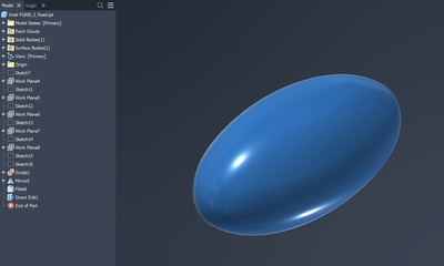

Hi! I don't think you need to use Freeform workflows to create the geometry. You may use regular Part Modeling features to create the shape (a mushroom like Revolve, a symmetric cut from the top, and a few fillets to round off the edges). The resultant shape may not match the point cloud precisely (but point cloud isn't precise to begin with). The rest of the part can be created by using Revolve command.

There are multiple ways to create the egg shape. In this case, I use Revolve command to create a round surface. Solidify it by using Sculpt command. Mirror the body and round off the sharp edge. Lastly, use Direct Edit -> Non-Uniform Scale to deform the shape. The resultant geometry is as smooth as it can be.
Typically, I would use traditional modeling commands like Revolve or Sweep, before resorting to Loft, Freeform, or Boundary Patch. The reason is simple. The geometry created by those traditional modeling commands is like a universal recipe. If you apply the same geometry input and use the same command in another mechanical tool, the result will be the same. Just as you follow the recipe and use the same ingredients, you will get the same dish. While Loft, Freeform, or Boundary Patch rely on proprietary algorithm native to the CAD tool, the shape may not be replicable elsewhere. Please take a look at the attached file.

Thank you for the response! I looked at the file and I fully understand what you mean and way to model it using ordinary modeling techniques. But I am not fully satisfied with the difference between the pointcloud and the model. See attached image.
I have some ideas now that I will try and post in this thread shortly. Thank you all for the answers to my question so far! Stay tuned for the end result.
