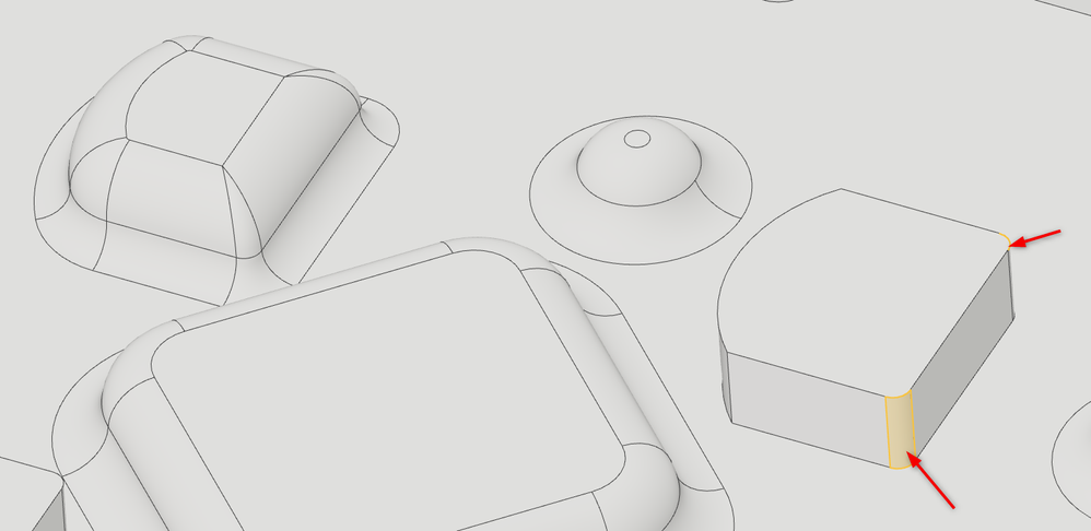

Hi everyone, sorry If my post is breaking any rules but I need some help making a specific fillet on a detail. Currently doing a school project and my teacher told me to fix my fillet on the small detail to look like the one he did in the picture ,,red detail"  but he didn't give me what radius he had used since it's an individual work. After hours of playing around I managed to get somewhat close as seen in the picture ,,my detail" but I just can't figure out how to make it work like what he has done so I need some help with it. I added the file in the post if someone can  take a look at it, the fillets in the file are 18,19, 20. I am using Inventor Pro 2018

Remove the existing fillets (highlighted) from your shape and try again.

thanks, that fixed it and now it looks very good.
