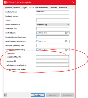

You are talking about these iProps, right?
(these properties control the "ReservedForWrite"-Stuff...)
I know how to remove them, but this has nothing to do with this, as the file, that threw the once-in-a-million-times-message was pretty new.
And to answer your initial question: we are working with a networkproject ... all the time. And by the time we were using vautl-projects, the familiar message popped up occasionally too, when people have clicked away the warning that the vault is going to overwrite their local changes too fast - but never the unfamiliar one. So that doesn't seem to be the clue either.
