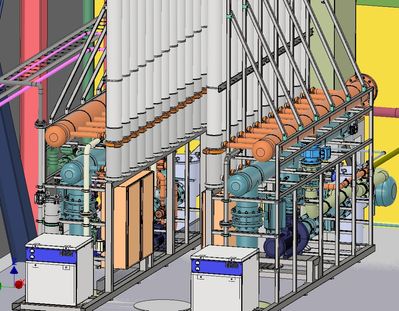

I need a frame and a mirrored version of it. Some parts are custom, some content center, and some of a company library folder. We have a partlist of the original frame, and need also one of the mirrored assembly. Parts that can be reused may keep the same name, but others need a new name.
For the predesign I used a derrived part that I could mirror, but it is not sufficient for manufactoring and ordering
What would be the easiest way to create (and future update) the mirrored version?
I attached a pack n go of the left fame. Many thx, Johan

Part of the entire assembly, some piping assemblies are different too.
