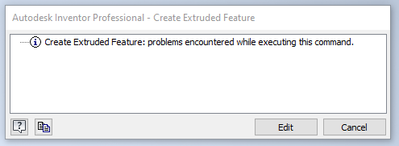

4. Go to extrude. Get a red outline, with no further clarification. Click okay, and am met with the mega-informative error message:
There's really nothing I can do with this lack of information.

The sketch that you are attempting to Extrude is at the assembly level - not at the part level.
Can only Extrude-Cut material at the assembly level and there is no material to cut.
This is logical behavior and has nothing to do with being imported STEP geometry.
To edit the part - right click Edit on the part node to edit within the context of the assembly or Open.
Note the additional options besides Cut when editing at the part level.
