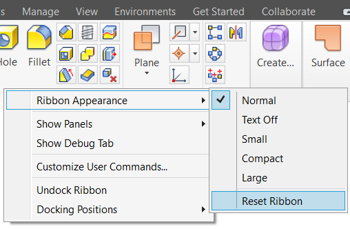

You can either reset the ribbon:
Or run the Reset Utility.

In the second step, right-click on the menu bar at the top of the screen and select Undock Ribbon then press the M key or Measure Tools ، you will see that the measurement panel appeared !
In the third step, right-click on the toolbar or top menu bar , and select the Ribbon appearance > reset Ribbon  option
