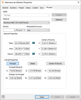

Don't worry I like good story, interested where this might go. Except some weird unit I don't observe nothing extraordinary.
After extrusion:
My version: Professional 2022.3, 64bit, build 350

The key observation is that with solid bodies you can get the Mass Properties information.
You could have exactly the same surface body, but you do not get that information.
But surface bodies are perfectly fine (and sometimes preferred) in many design cases.

michal879ZE
Thank you for your files and examples. Interesting to see all types and looking at different behavior.. of course leading me to more questions 😄
It is interesting that area is computed only for solid bodies or surface body:
Just my, giving your conclusion from last post, probably fail thought process:
So surface body has some resemblance with solid body, guessing it remains (going from solid to surface body) the surfaces by solid ... which is "simpler " than "real" surface?? .. so it is able to compute area??... simpler for inventor less file size: 7 MB for solid or surface body and 12 MB (or 11 MB) for surfaces.....? Is there really no difference except file size? And please don't take it as poking holes in your text 😄

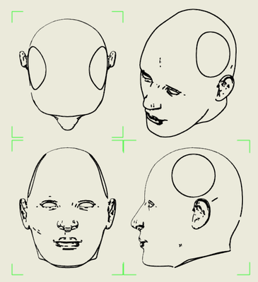

Examine these two imported mesh data files.
If you examine them very closely - you will note that there are ONLY straight lines and triangular planar facets in the file.  No curved faces.  Not one.  Only lines and planes that sort of look like curved surfaces.
However - we can still create 2D drawing views of the mesh geometry...
