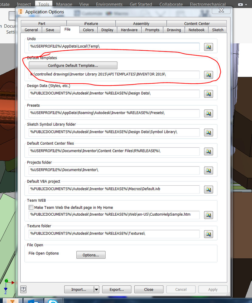

We been running into problem with inventor 2019. A few of us have are templates setting return to default a few different times and all the projects disappear in the project file list.  Anyone else experience this ?

Your template issue sounds like you have a styles conflict message.  Are you seeing a styles conflict message when you start creating parts/assembly/drawings?
For your project lose it sounds like the Inventor profile is messed up and not saving information.  Run the inventor reset utility on one machine to see if that resolves the issue.

We don't see any messages. Just when we go to create a new part or drawing, the templates are gone.  We have to go in settings and reset the file location.

It sounds like the project file is incorrect.  Where are you setting your template location?  Via Tools/Application Options/File tab or through the folder options of your project file?

So its a network location..  When you launch Inventor are you 100% sure your network connection to that network drive is "live"?  When are you seeing this issue where it doesn't work?  Upon first launch of Inventor or throughout the day?   Have you tried an UNC path syntax instead of a hard code to a network drive?

We see this problem through out the day. We save our templates on a network drive because how many people we have using it. Only couple people has had issues with the templates. Three of us had problems with the projects being gone. So it's not everyone who uses it just a few of us. I Have experience both only one time each.

Hi! Are you on 2016 or older releases? I believe the behavior you are seeing is indeed the way it works back then. It has been changed to a more friendly behavior without deleting the original templates (2017 and later).

Hi! The only logical reason I can think of is that you don't have a stable \Templates\ path defined in your project. The active template path is actually dictated by Project setting -> Folder Options -> Templates. You can go to Tools -> Application Options -> File to set the default Template path. This option only dictates the "default" template path, meaning in a project if you don't specify the template path out of box.
If you inherit somebody's project, you need to make sure the setting in the project is correct. You can either change it to "default" (based on App Options) or select a folder path where the template files are stored.
