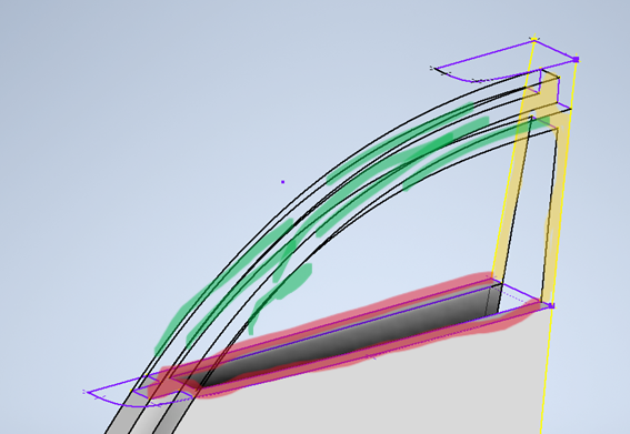

Hello, I got two sections, both of them with a diferent outline. They touch eachother on the base, 90 degrees separated. I have multiple rails and I believe all the points and everything is correct. However it says it doesnt display a meaningful result.
In the picture you can see on red one section, and yellow the other one. On green the rails.
help please

CCarreiras
Hi!
It's hard to say something just looking for the image...
Can you share the part?

@a.sanchez-quinones
Sketches do not appear to be fully defined.
The sketch on the face of the part is not needed.
Attach your *.ipt file here and end all doubt.

Hi! I could be wrong but this case might be better modeled using Guide Rail Sweep. Please share the file here. The forum experts and I can help take a look.
Many thanks!

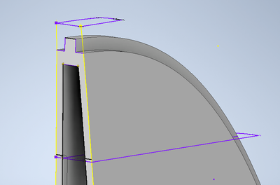

I have figgered that if on the vertical section I put two lines so both sections are not in contact, it can loft, however, it makes of course a weird solid on the base. Sorry for my english, I think you will understand better with the pics:
So I guess I am doing something wrong where both sections touch eachother. Not sure what it is but I guess it the mistake must be there.

Let's go back to the very beginning.
Is this line highlighted green supposed to be Horizontal?
Does Manage tab >Rebuild All return any errors?
None of your sketches are properly defined.

Hi! I took a quick look at the part. I would use a different modeling technique. You try building the solid body by using the detail profiles. It makes the geometry unnecessarily complicated. This part is better modeled using Surface Modeling technique.
Please take a look at the attached part. I used some of the rails to create a smooth Loft surfaces. The detail geometry can be created after the surfaces become a solid body. The key point here is to reuse existing geometry as much as possible. Avoid recreating geometry as much as possible.
