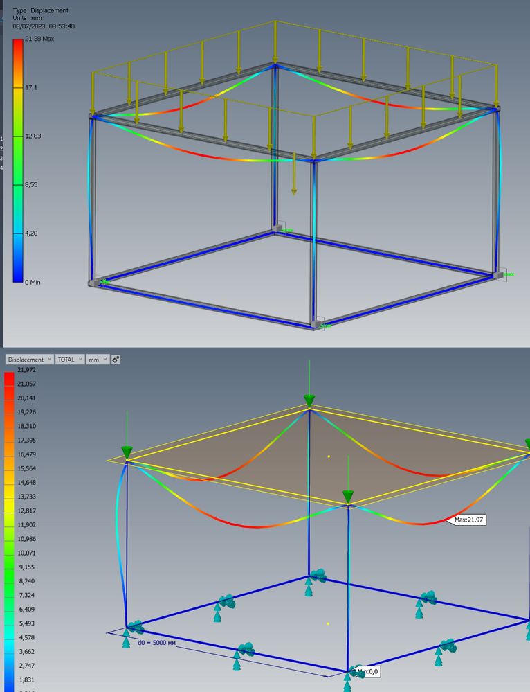

when calculating loads
1 in stress analysis environment
2 in autodesk nastran environment
i have different offset data what
i am doing wrong?

initial data
1 frame 5000x5000x3000 mm
2 profile square pipe 100x100x7 mm
3 load 10000 kg
Message 3 of 15
admaiora
I see a finite element analysis (inventor) and a beam analysis (Nastran).
Am I wrong?

No i didn't say that.
The order between tetra and linear elements is different.
From your pic (it seems) you are comparing a linear analysis with tetra elements (in Nastran) with a linear structural analysis in Inventor (beam linear elements).

admaiora
Inventor 21,38 mm  (frame analysis)
Nastran 21,97 mm (frame analysis)

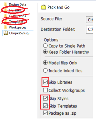

Tip 1.  When you Pack and go - Templates are not needed and usually not Libraries and Styles.

89198826955
I get an offset of 38 mm
1 fixed on the plane
2 plane pressure
(10,000 kg * 9.8) / (0.325 m ^ 2 * 4) / 1,000,000 \u003d 0.076 MPa
 What am I doing wrong?
