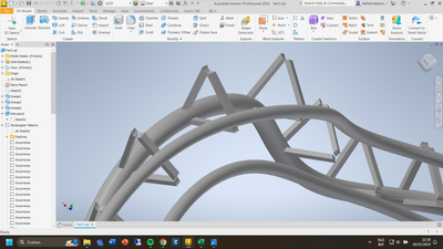

Hey, I recently came upon a problem when designing my rollercoaster. I want to let the triangles follow a spline (from the coaster) so that they strengthen the track. My problem is that i can't let the feature follow the spline while touching with the rails using a rectangular pattern. With some it works but in turns it won't.
Is there another way to do this? Or can i use a setting thats says that I want a point of the triangle to be touching a rail?
Thanks in advance!

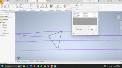

nathan_degusseme
Hi @kacper.suchomski
I tried using the icopy feature. I googled some tutorials, but on all youtube tutorials it automaticly selects a work plane. When i try to use the function it doesn't generate that and i can't select one because it gives me an error saying it doesn't intersect with the path.
How can I fix this? Or did I do something wrong in the icopy template?
johnsonshiue
Hi! I have been taking a look at this case on and off. This is actually quite challenging to do in Inventor, due to lack of patterning alignment control. I end up having to use surface modeling techniques and also Frame Generator to get the desirable result. Though it is not a one step process, it should be highly scalable. Please take a look at the RollerCoasterRailSystem.ipt in attached file.

Eventually my track should look like this:
Thanks a lot!
johnsonshiue
Hi! Unfortunately, I don't think I can record a video showing the workflow. It is quite elaborated. I tried quite a few techniques and the attached model is the best one.
The most challenging thing is to get the projected points of the support posts along the path. I created three offset surfaces based on the railings. Then project the patterned workpoints normal to those offset surfaces. This guarantee the shortest length. Then create a 3D Sketch and connect the points. Next, use Frame Generator to create the posts individually. Lastly, use Derive Assembly to combine the posts and the railings.
