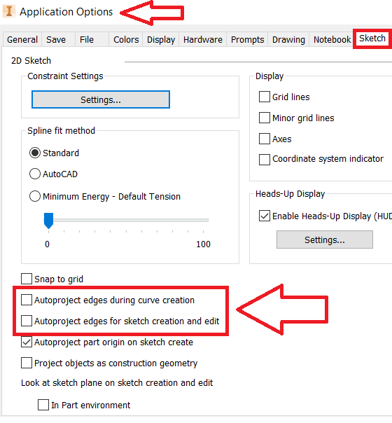

JDMather
@Anonymous wrote:
…. This causes my current sketch geometry to snap to it and it's just way less tidy. Is there an option to disable this?
Tools>Application Options>Sketch tab unselect the Autoproject options (except for the part origin - I leave that one on).
