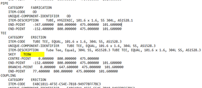

In our company we do piping model in inventor and until now we were doing the isometrics manualy in autocad. Now we are in process of implementing plant 3d to extract the isometrics. This is done through pcf / isogen files. So it is very important that the pcf files exported by inventor has very comprehensive information (which it doesn't). You can compare the PCF files generated by inventor and Plant 3D of same piping and see the difference. I am planning to post series of threads on this topic so that we can discuss each issues on separate posts.
In this post i want to talk about SKEYs (e.g. blind flanges). In Plant 3D we can type in (makeup) any SKEY we want. In Inventor we have very limited list of SKEY to select from. See below SKEY used in Plant 3D (FLBL). FL for flange and BL for blind.

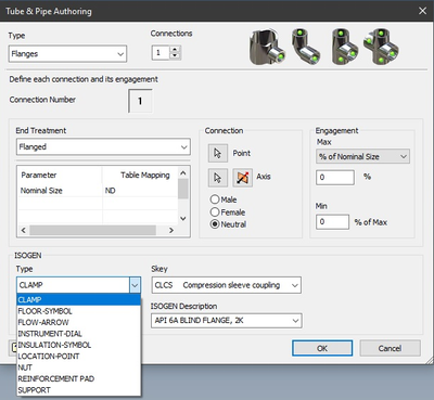

Now see below options given in Inventor. There is nothing related to blind flange (or any kind of flange). Doesn't make any sense.
Considering that both the softwares are from autodesk we should expect some kind of symmetry between the two.
Selecting SKEYs from a drop-down list is a good idea. This helps us to decide which SKEY to use, specially for the users who are new to these softwares. But atleast we should have matching SKEYS in both softwares.
And if possible, Inventor should also have an additional option to just Type-in any SKEY we want.
Let me know if i am doing something wrong.

What i am trying to do here to create the inventor library (as close as possible) compatible with Plant 3D. So the PCF files does not require any editing after i generate it. I want my workflow to be like,
Step-1: Generate PCF files from inventor.
Step-2: Go to Plant 3D and use "PCF to Pipe" command to generate the model.
Step-3:  Check and solve any leaks. Add field welds, supports, etc..
Step-4: Generate Isometric.
A.Acheson
It seems when you place flange as custom the type and Skey are there. I am not sure how you are meant to get these values entered on a new part author.

aprajapati3C
@A.Acheson i noticed that the required type and skey doesn't appear for ipart with single port.
so its there for non-ipart and
ipart with 2 or more ports.
i think this needs to be fixed.

Yijiang.Cai
Tracked as [INVGEN-74929], which is being worked in progress, and will keep you updated. Thanks!
