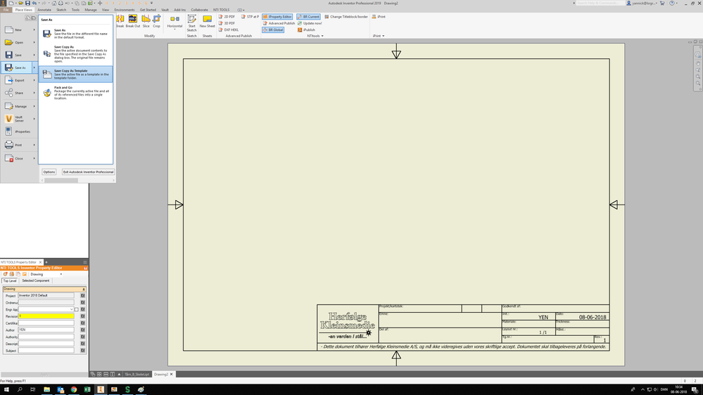

Hello @Anonymous
Right click on the title block as shown in my attached images
After that, save your drawing as template as demonstrated on the last image

Message 3 of 15
i have tryed to make the changes that you deskribe. but the changes is only made on that one title block.
i tryed to start a new drawing but then the title block i from the standard template.
i dount know how to inset my own template so it will become a standard

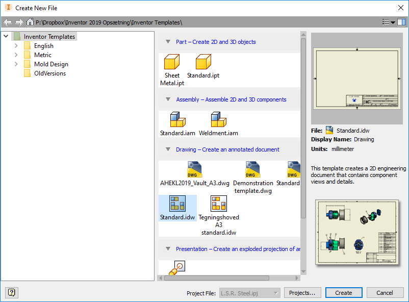

Message 11 of 15
this is the why the company whants the template to be.
and as i can see at the side then the template as i called val controls is the one used here.
but if i try to open a new drawing then i can delete the ISO template but i cant insert my own. every time i try to insert one it is just the standard ISO template that apperes

It sounds like you haven't saved it correctly if you can't find it.
Save Copy As Template leads to your template folder. You might mistakenly have saved it elsewhere?

Hello @Anonymous I see that you are visiting as a new member to the Inventor Forum.
Welcome to the Autodesk Community!
Make sure that when you do the Save Copy As Template it is in the templates folder:
C:\Users\Public\Documents\Autodesk\Inventor 2019\Templates
Also make sure that you are selecting the right folder from within Inventor Create New File as there are different files in Templates, en-US, English, Metric, etc.
