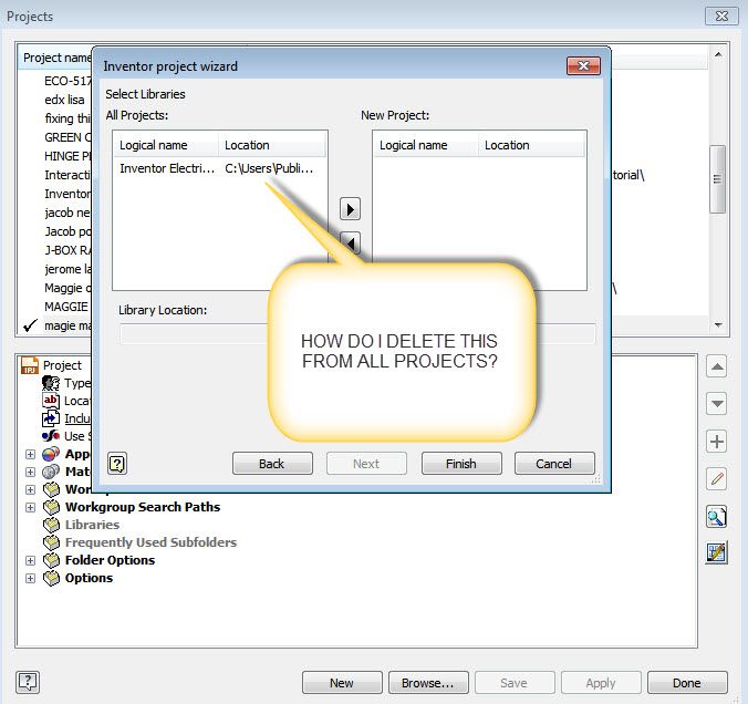

how do i delete a library from the all projects list while using the inventor project wizard.
we do not use electrical, and wish for it to be gone.
thanks in advance

You cannot use the Inventor Project Wizard to modify existing project files, it is only used to create new ones.  You can browse to the folder where your project files are saved, normally you top level workspace folder, make sure each one is not "read only" and then right click on each one,  select "Edit" from context menu.  You can then right click on the library you wish to remove and choose delete from the context menu.
