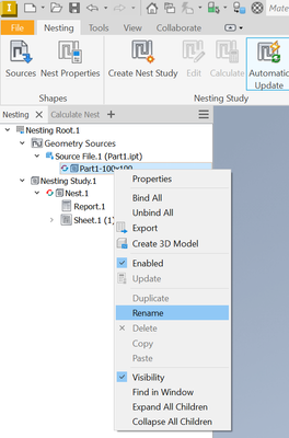

@youssef-nabhan, is that possible to try to rename the source shapes name? That will reflect to the part name in the legend.

@WillsonLeng, thank you for your answer. But I have more than 500 items each of unusual shapes and different dimension, meaning this way would take days to complete, not to mention the bigger error percentage during the operation. Is there an automated way to do it (especially since the part number reflects all the dimensions) instead of doing it manually?
WillsonLeng
@youssef-nabhan, got your point. Sorry about that, I'm afraid there is no such automated way to do it by now.
