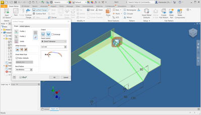

Good afternoon,
I have a problem with lofted, the bend goes auto to a corner. but there need to be two bends to the other corner (see photo)
can anyone help me.
With kind regards, Roel from Holland

Hello, You can try model the half of element
and then mirror it.

Thanks for your response.
I've tried it.
but now it still goes to the wrong side. am I doing something wrong
It is very strange.
On Your first screenshot the right side of model was correct - do first the right half of element

kacper.suchomski
  1. Click on the sections in reverse order.
  2. Change Loft mode.
Kacper Suchomski
Reulingkoudetechniek
It worked, it's strange that you can't choose the angle.
Thank you for your time.
