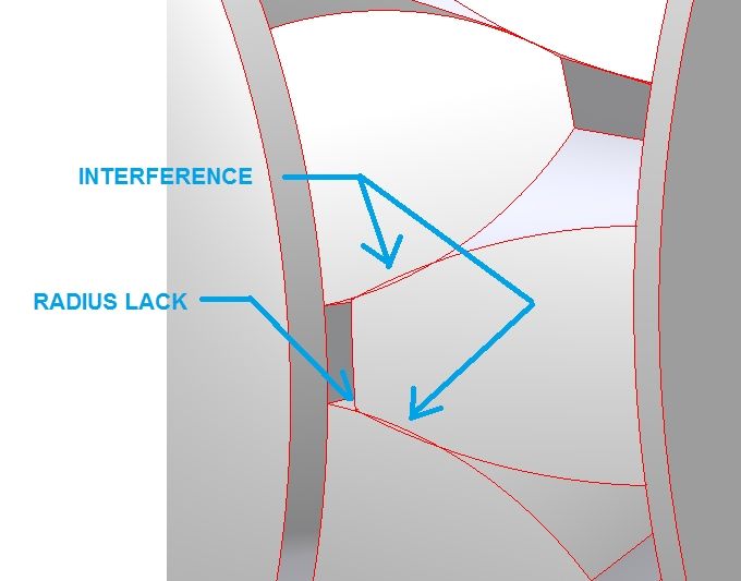

Kelly.
See the pictures below for the errors that occur when modeling conical gears in Inventor.ERRO.jpg

jan_priban
I am not able to help you with GearTeq .... I want only to confirm you are right: only spur gear is accurate enough, worm and bevel gear use simplification.
