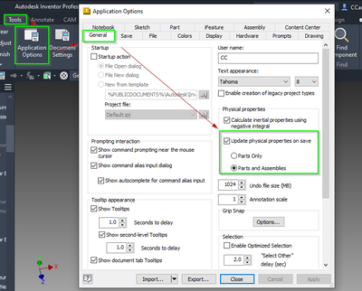

Hi
My inventor drawing shown the weight in the title block,
After updating a component, it doesn't show the weight. Then click the update button and restarted the inventor also.
It doesn't work ?
What could be the reason.
505 Views
CCarreiras
Hi!
can be a lot of things...
Try this:
CCarreiras
johnsonshiue
Hi! Another way is to ppen the source model (presumably an assembly). Update and go to iProperties -> Physical -> Update -> Save.
Many thanks!
