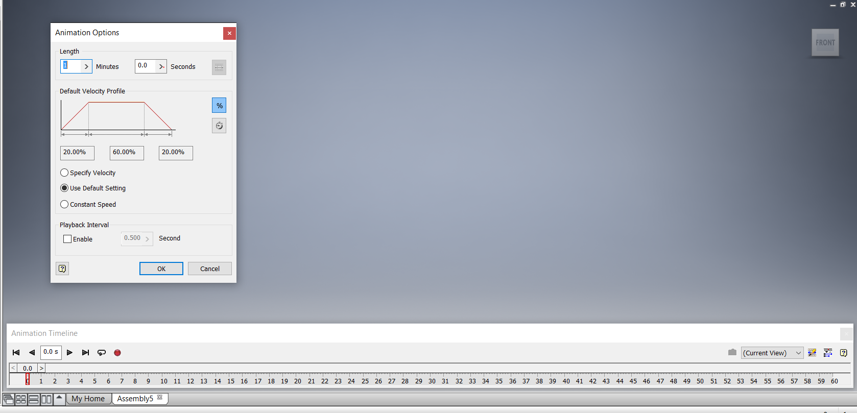

Hello.  I was wondering if there is a way to make an Inventor animation that is longer than 30 seconds?  Thanks for any help.

under animation options ....
I recommend that you never do this as you are likely to eat up all of your RAM.
A better solution - make several animations and then stitch them together using free Microsoft Movie Maker.
There is nothing more frustrating than having an animation rendering for several hours only to find that the computer ran out of RAM on the last slide.

I thought I would point out for others coming across this thread that Inventor can be set to automatically create each individual slide file (or you can leave it on the default to create the video).
