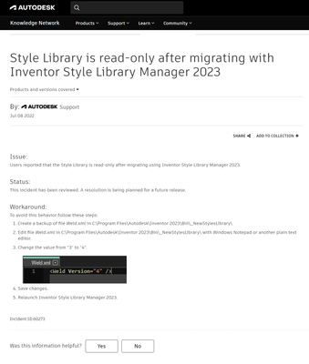

I have recently installed inventor 2023. I used the style library manager initially seemingly ok but now I cannot get it to work.  (I forgot to copy some old styles to the new library from my old library) I get "read only" I have set one of my projects to read_write for the styles attribute.  I also tried setting the folder attribute in file explorer and also using attrib in CMD.  They seem to revert to read only all the time.
I tried the work around as below but got the screen shot below that.....a message about migration but migrate is greyed out.
Any help appreciated.

I am using 2023.1 and having this problem.  I tried changing the weld.xml, but don't seem to have permission?

Hi! I am sorry I don't understand why it does not work for you. The issue is indeed fixed in 2023.1 update. It could be install related. Maybe you want to uninstall Inventor 2023 and 2023.1. Then reinstall them.
