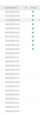

jack.hou.in2power
From screen shot below, we can find the sort by Date Modified on home page of the Inventor 2023 doesn't work.

sundars
Hi @jack.hou.in2power
It's working fine on my US version where dates are in the MM/DD/YYYY format. I wonder if the sorting doesn't work correctly if its in DD/MM/YYYY format. We will investigate this and get back to you.
Thanks for reporting this.

sundars
I have created a defect INVGEN-61044 for us to investigate. Thank you for reporting this.

sundars
Hi @peter.kapitola
This issue was fixed in Inventor 2023.1. If you haven't applied those updates, please do so. If it's still an issue, can you provide some steps to reproduce.
-shiva
Shiva Sundaram
Inventor Development
Message 7 of 8
peter.kapitola
I have installed 2023.2 and it's working now. Thanks.
