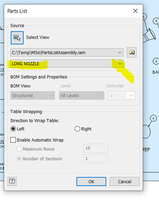

... but with the help of your files, I think I see what is going on...
When I looked at your Parts list, I noticed it was referencing the Master state
When we create the Partslist we select a view and can set which state it is looking at...
I think the ballooned status is tied to the view, which is referencing the model state.... so this is what's going on.
In your case, the parts list is looking at the view called "Shell and Long Nozzle Only..." and showing only those three balloons as "ballooned"
I hope this helps.

I see the pull down now when placing the Parts list.
To keep all the Item numbers correct, changes should be made to the BOM only, not the Parts List?

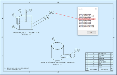

Here are some notes on what you were seeing in your markup
I hope this helps.

It would be nice if there was a model state filter, or if the parts list would automatically set zero qty items as hidden, but neither of those options are there. Agreed
This confirms my suspicions. Thanks for the clarification.
