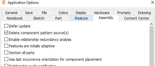

In inventor have you unchecked the "Enable relationship redundancy analysis" setting in application options?
