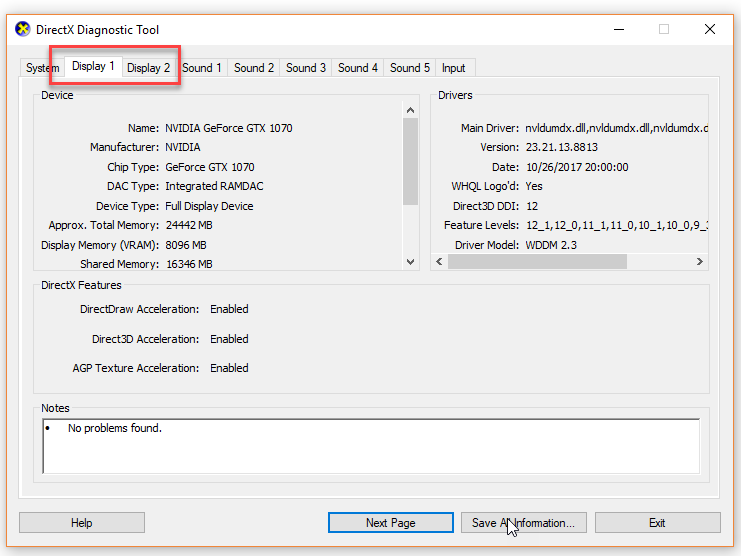

mdavis22569
Try using this driver, I have 2 devices with this card and not issues ..
Mike Davis
Message 9 of 10

@Anonymous
Great to hear ...
I've found the newer drivers give me issues, but I've been using this on 2018 and 2019 Inventor without any issues..
But I also have all of the updates / enhancements installed.
Mike Davis
