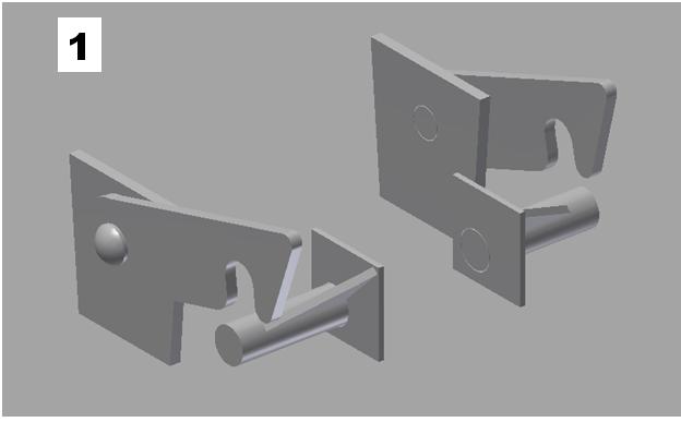

Here's an example of the original lighting in image one.

I tried to modify the lighting in the assembly to make it this way but the .idw remains unchanged.

I'm not aware of a way to edit the Lighting Styles of a drawing like you can on the model files. As you know now, changing the lighting in the model files has no effect in how the lighting behaves in the drawings.
The only trick I know of is to disable the specular lighting for drawings. It's a registry edit and you can read on it here http://inventortrenches.blogspot.com/2011/02/disable-reflections-and-gradients-in.html
Based on your sample images of the geomtry I'm not sure how much that might help (or hurt) you in terms of how the views are represented.
