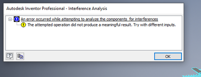

Hi all,
Im using Interference analysis frequently but Im getting this error for the first time.
Do you have any Idea why it would do that or how to approach to the problem in order to solve ?
Unfortunately I cant share any part or assembly doc.

johnsonshiue
Hi! This can happen when there is bad geometry or the two components have near tangent intersections. Try a few things real quick.
1) Make sure there is C:\Temp on your machine. Go to Inventor assembly -> press Ctrl+F7. Is there bad body reported? If yes, open the part with bad bodies and go through Repair Bodies workflow to fix the badness.
2) Try selecting two components do not interfere each other. Run IA. Does it work? This means there is one or more particular components causing the failure. Try narrowing down the offending part.
