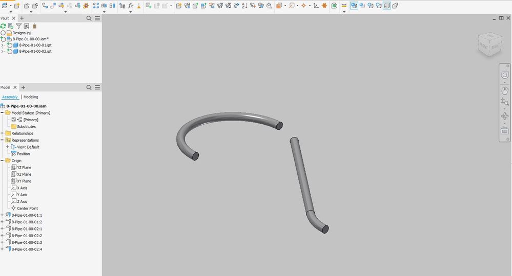

The only issue I am having is with the constraints and getting all of the parts to align and miss each other.
Message 10 of 12
Pineapple2024
Model it flat.  Whoever welding it should be able to "twist it" to fit.
Make the 2 loop and fit straight to them.
