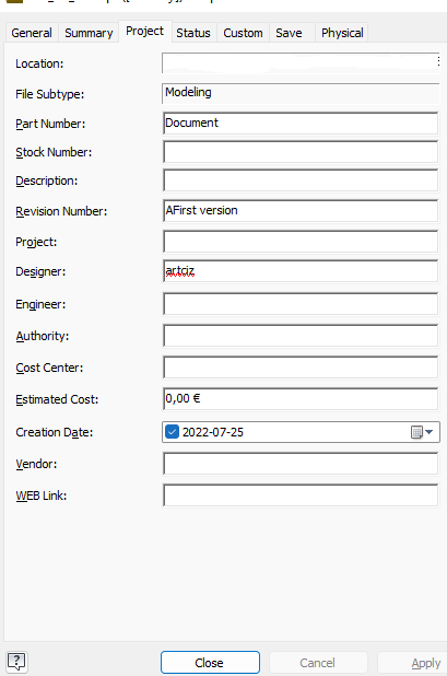

2023 version has a problem that while importing step file , Part number allways comes with name "Document".
Previous version named files by file name.

Hi! I am sorry I did not see that there was a file attached to the thread. I took a quick look at the STEP file. I can reproduce it on my machine. But, I believe it is working correctly. Here is what I find.
STEP file is text-based. You can edit it in Notepad. Look for #135. This is what was exported by Rhino. The Part Number is indeed "Document." Inventor simply imports it as such. Do you know how to change Part Number in Rhino? Maybe you want to change it and export it from Rhino again.
#135=PRODUCT('Document','Document','Rhino converted to STEP',(#134));
Many thanks!

@cizart_ wrote:
The problem, that it should be work by default. Part name should be the same as file name.
I think that what @johnsonshiue is saying is that it IS working as intended.  Inventor is pulling in the Part Name from the step file you are being supplied with.  The file you are given contains data that sets Part Name to "Document".  Inventor is simply reading that and putting it into the iProperty.
You probably could edit the step file with something like Notepad, and change line #135 to be whatever you want it to be.
